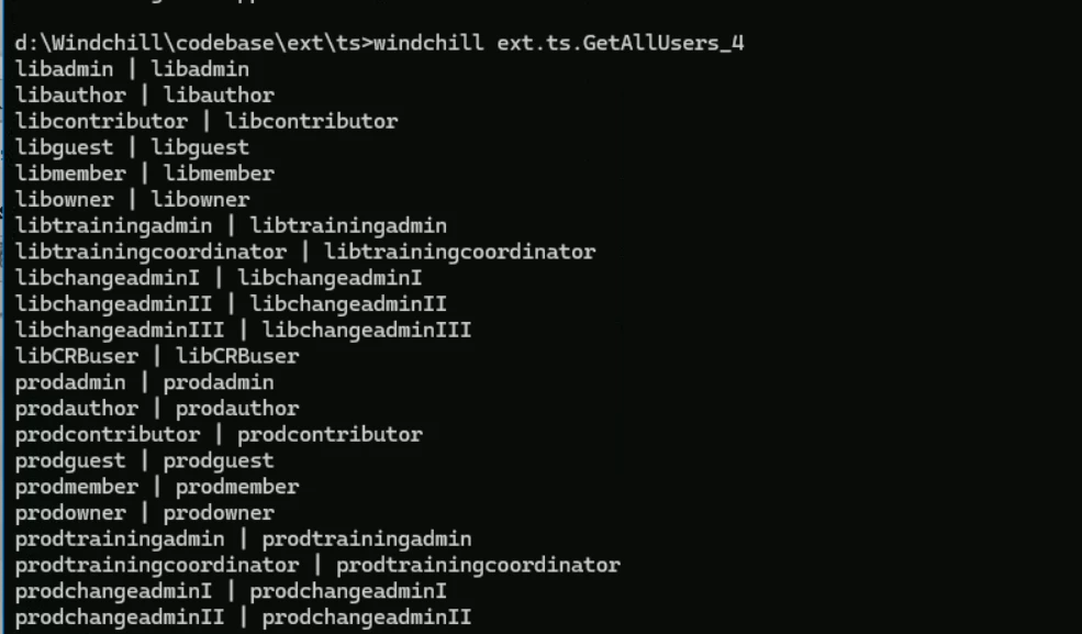

this could be caused by picky java version used regarding remote execution ,  try something like below with Queryspec :
package ext.ts;
import wt.org.WTUser;
import wt.fc.QueryResult;
import wt.query.QuerySpec;
import wt.fc.PersistenceHelper;
import wt.util.WTException;
public class GetAllUsers_4 {
    public static void main(String[] args) {
        try {
QuerySpec qs = new QuerySpec(WTUser.class);
QueryResult qr =PersistenceHelper.manager.find(qs);
while (qr.hasMoreElements()) {
WTUser user = (WTUser) qr.nextElement();
if (!user.isDisabled()) {
System.out.println(
user.getName() + " | " + user.getFullName());
        } catch (Exception e) {
            System.err.println("Errore durante l'esecuzione locale nella Shell:");
            e.printStackTrace();
Buiꓘa
