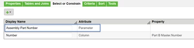

Use Case: Hello, I´m trying to build a report, that will allow me to enter a assembly Number and the result of the report should be a list of unique objects, only used in defined assembly Number. I have managed to build a report reporting items used in assembly, but I´m having trouble setting Criteria to only report unique items.
Description:
I´m currently getting a result with the list of the objects, but report is simply listing objects used in specific assembly, whether they are unique or not. I can´t manage to set Criteria correctly, so it will only report unique objects. Can anyone point me to some guide or assist with setting correct criteria to achieve desired result (only report unique objects used in one assembly)?

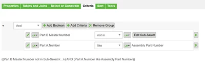

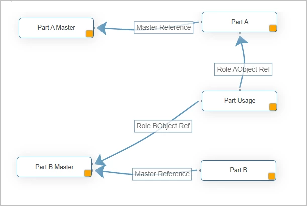

You could do this in Query Builder, with some more advanced criteria.

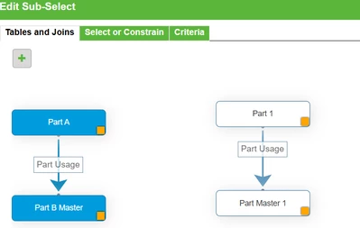

You would need to add a criteria that the Part B Master Number is NOT in a Subselect.

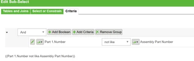

The subselect would be Assemblies using Parts, with the additional criteria that the assembly's number is NOT Part A's number
So in English: Return all the part numbers in this assembly that are NOT in any other assembly
I'd recommend using a Parameter to enter the Assembly's Part Number for performance reasons. That would look like this:

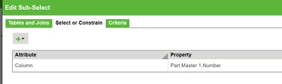

You would need more criteria, but here's what you're missing:
And here's the sub-select:
This is referring back to the same parameter as before:
