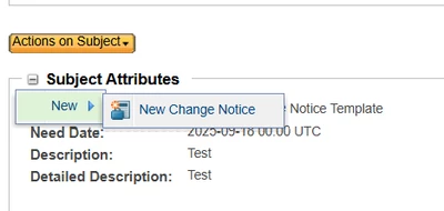

Sep 25, 2025 12:52 PM UTC
I am not looking to create the Change Notice Automatically, I receive this task to create the change notice and there is an action to do so.
But the specific task do not have the complete button, because of the wrong activity template. I cannot set it from the UI because it I need to check for certain validations on start  of the activity. Let me know if you need more clarity on it.

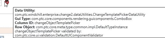

Sep 25, 2025 7:31 PM UTC
So we are clear, you are looking to have this drop down that selects the change notice template to default to a specific one based on some custom logic, correct? Where would be the source information for this decision maintained?
This is the information on that drop down:
