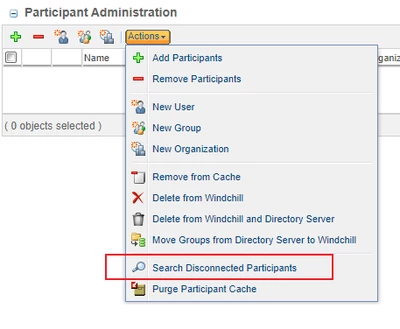

Hello All,
Is there any API which can help to update existing WTUser with another WTUser.
For Example, If john is one user who is part of many groups and change processes and he leaved the company now I want john should be replace with Max. All the existing task which was with john should be assigned to Max.

Hello @Rocket_Max ,
I don't want to use it for seprate Workitems .
I just want old user should get it replace everywhere inside windchill.(e.g Inside teams, roles and all change items)

I don't see any similar records in the knowledge base...
Do you want to try "old user has been disconnected and reconnected to a new username" This seems to meet your requirements, but there are no similar records in the knowledge base either
If you are testing, why not give it a try
