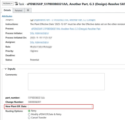

Use Case: We have a customized Workflow that has a Date as variable (actually, I would prefer a date like LocalDate for the user, but Windchill is still proposing the java.date.Date). I would like that a user can set the date during a User Task.
Description:
The variable is shown a a text, without any format hint for the user, and the conversion to Timestamp depends on the timezone of the user (if the String is not completely filled) ...
How could we provide a date picker as input instead of a input text ?

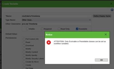

Nov 10, 2025 4:39 PM UTC
When trying to define a variable as Timestamp (similar to PTC's variables), I get the following error from the Workflow Designer.

Nov 11, 2025 9:06 AM UTC
Hello @HelesicPetr, thanks for your searches.
It would have been a convenient way for the users but do not want to customize so much. I guess they 'll have to go on related part themselves and set the attribute from there.
I am wondering whether the use of Timestamp (instead of Date) could help  (as PTC uses such variables in Workflow activities. The Workflow Designer does not allow to define a new variable of this type.
