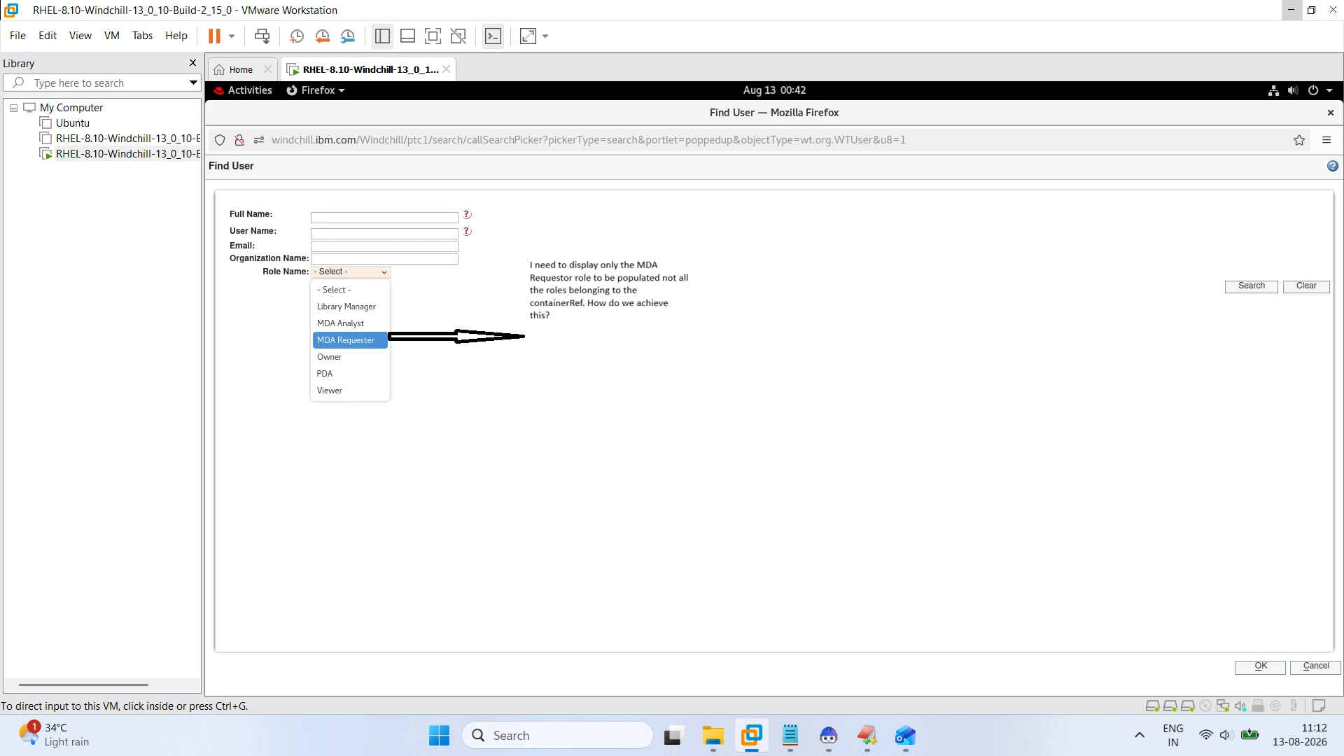

Hi ,
I am attaching the screen shots , Hope this gives a better understanding of the problem. Thanks
Jul 22, 2026 12:57 PM UTC
Basically Is it possible to filter out User results based on a certain Role (Requestor) in the search results.

I tried the Setting showRoles="true" containerRef="${containerReference}" and in the Search step it displays a drop down of roles assigned to the Container, the issue I need to filter only one Role from the drop down.
I am attaching the screenshot of this, is it possible to do this or it needs total customization of the search?? Please let me know your thoughts.

I don't think there is any OOTB parameter available to handle a specific role.
I would suggest implementing a custom JS function to handle the role.
