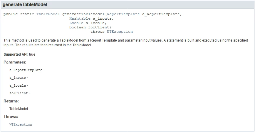

I first started looking at the out-of-the-box Nonconformance reports to get an understanding of the object family structure.  That led me to trying to find the APIs for Nonconformance, didn't find any as there are no such supported APIs documented in JavaDoc.  If I have a report, then I'm getting the information I need.  How does the report present the information?  Can I use the report itself?  My initial path was to get the URL of the report itself and parse the response for the data I needed... what a mess (and points to just how new to this stuff I am).  Then I found ReportTemplateHelper.generateTableModel().  This was my ah-ha moment.  I can build a report template that has all the information I need for a task, a notification, a custom jsp, and generate a TableModel then parse it like a 2 dimension array and display its contents.
So, here's how I do it...  First I need to generate the TableModel.  To do this I use the following method found in ReportTemplateHelper.
Here is the code...

				reportData = ReportTemplateHelper.generateTableModel(report, hashtable, null, false);

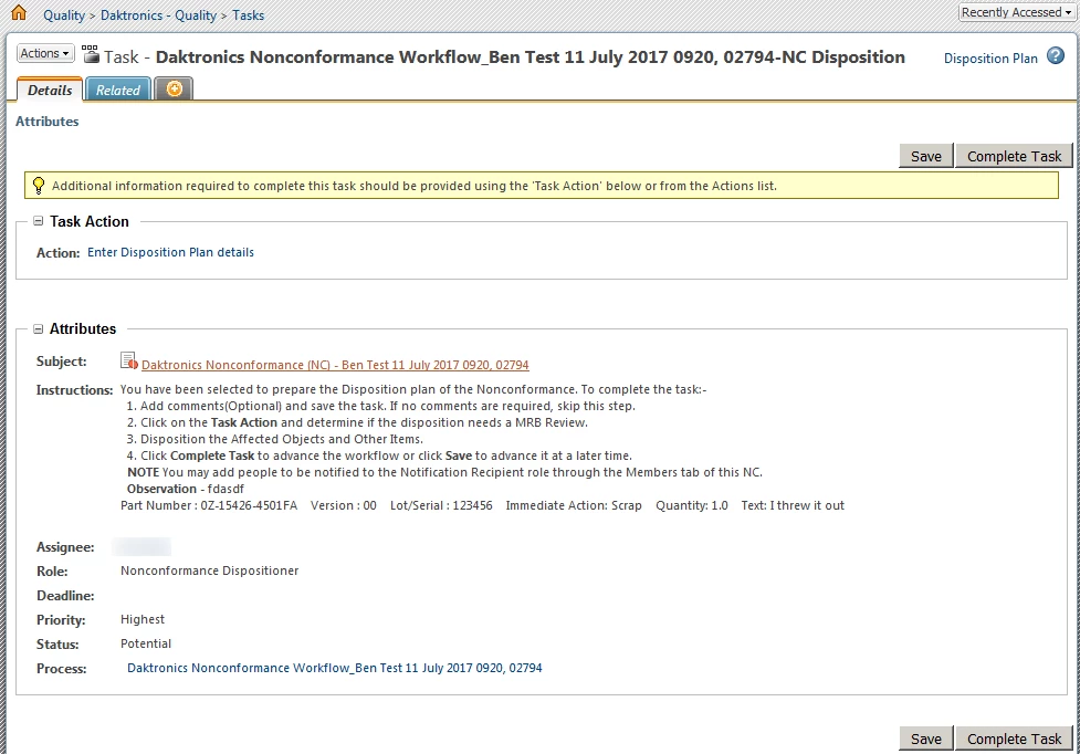

And the result looks something like...
I have used this method for independent jsp implementations (such has having a printable Nonconformance without having cognos), email notifications that include a list of affected objects and related people and places, and workflow tasks.
