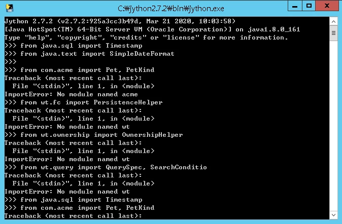

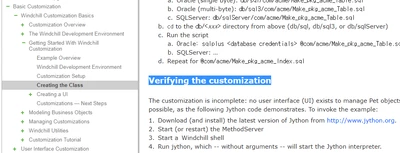

I am practicing a basic custom at the Windchill help center.
It fails at the stage of verification using Jython.
Please let me know for some reason.
Warm Regards,
SeonHo Cha.
Best answer by PASI-Consulting
You should check if your custom object have been deployed correctly to codebase. You should have your new object subtype in the type-manager.
June 17, 2020
