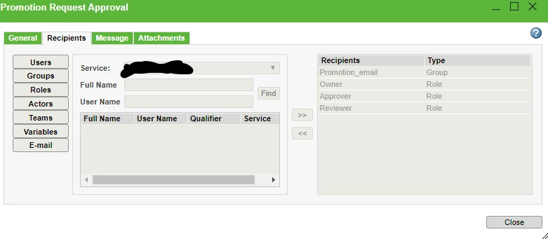

Hello ,
 We want to send mail to particular member from team after releasing the Promotion request .How we can achieve If we set notification robot then it will send to all user we want only selected users.
Dhananjay
March 19, 2020
Hi Dhananjay
All you would need to do is add the users to a group and the group to the approval email recipients, as per the image
Shaun
March 20, 2020
Hello Scaun,
We want selection of people to send mail after CAD relesed by Approver. This thing how we can achieve
Dhananjay
March 23, 2020
Hi Dhananjay
If you open the workflow their should be a notification box just before the end, if you edit that and add the people or group will work. If unsure please post an image of your workflow layout.
