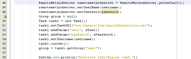

I have a webject to modify the password of a user. When I run this it produces the error: (com.infoengine.util.IEResource/81) com.infoengine.exception.fatal.IENotFoundException: File not found: /ext/savaco/lvd/QueryUserDetails.xml

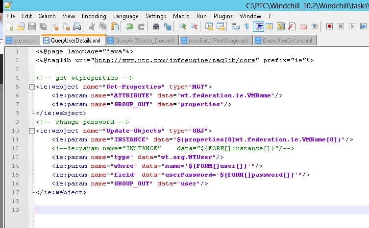

The xml file does exists at C:\PTC\Windchill_10.2\Windchill\tasks\ext\savaco\lvd and looks like;Snap14.png
The java code looks like:
Can anyone know why this error is issued ?

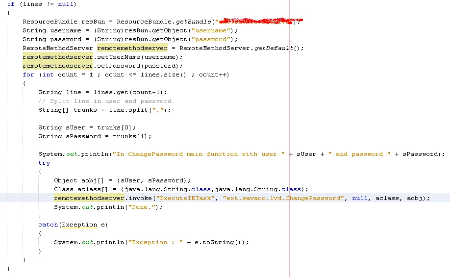

I answer my own question just in case this can be helpfull for someone else.
Apparently the method that contains the Info*Engine task must be envoked by the method server.

Feb 14, 2018 7:05 AM UTC
Example:
