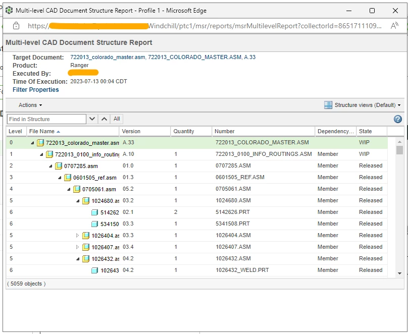

what api can be used to fetch cad structure using windchill rest api along with its quantity value
  • July 17, 2023
  • 1321 views
what api can be used to fetch cad structure using windchill rest api along with its quantity value as present in the below image

Hi @AP_10343008
The Image shows multilevel bom report that is not same as a rest api. This page is generated by own code that cares how to build the table. as
You need to use existing restApi to get onelevel BOM and then work in your site with results and go through the bom recursively
