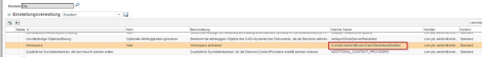

What is the internal name "DISPLAY-->workspace" in preference admin.
Hello All,
What is  the internal name of "DISPLAY-->workspace"  in preference admin?. I need to load this  preference  using LoadFromFile.
Thanks in  Advance

Hi SENTHIL,‌
Internal name for preference is "/com/ptc/windchill/cadx/CadxStandAloneEnabled".
And its definition can be found in "<WT_HOME>\Windchill\loadFiles\preference.foundation.xml" file. It is below:
<csvPreferenceDefinition handler="wt.preference.LoadPreference.createPreferenceDefinition">
      <csvname>/com/ptc/windchill/cadx/CadxStandAloneEnabled</csvname>
      <csvvisibility>USER</csvvisibility>
      <csvcategoryName>DISPLAY_CATEGORY</csvcategoryName>
      <csvdisplayName>com.ptc.windchill.enterprise.prefs.server.processors.PrefsRB:CACHE_SITE</csvdisplayName>
      <csvdescription>com.ptc.windchill.enterprise.prefs.server.processors.PrefsRB:CACHE_SITE_SHORT_DESC</csvdescription>
      <csvlongDescription>com.ptc.windchill.enterprise.prefs.server.processors.PrefsRB:CACHE_SITE_DESC</csvlongDescription>
      <csvdefaultValue>false</csvdefaultValue>
      <csvhandler>com.ptc.windchill.enterprise.preference.handler.BooleanPreferenceValueHandler:</csvhandler>
  </csvPreferenceDefinition>
I hope this helps you.
Shirish

Mar 1, 2017 11:49 AM UTC
Hi Shirish,
It works. Thanks a  lot.
Regards
Senthil
Mar 7, 2017 12:07 PM UTC
Easiest would be to add the column "internal name" in your preferences view...
