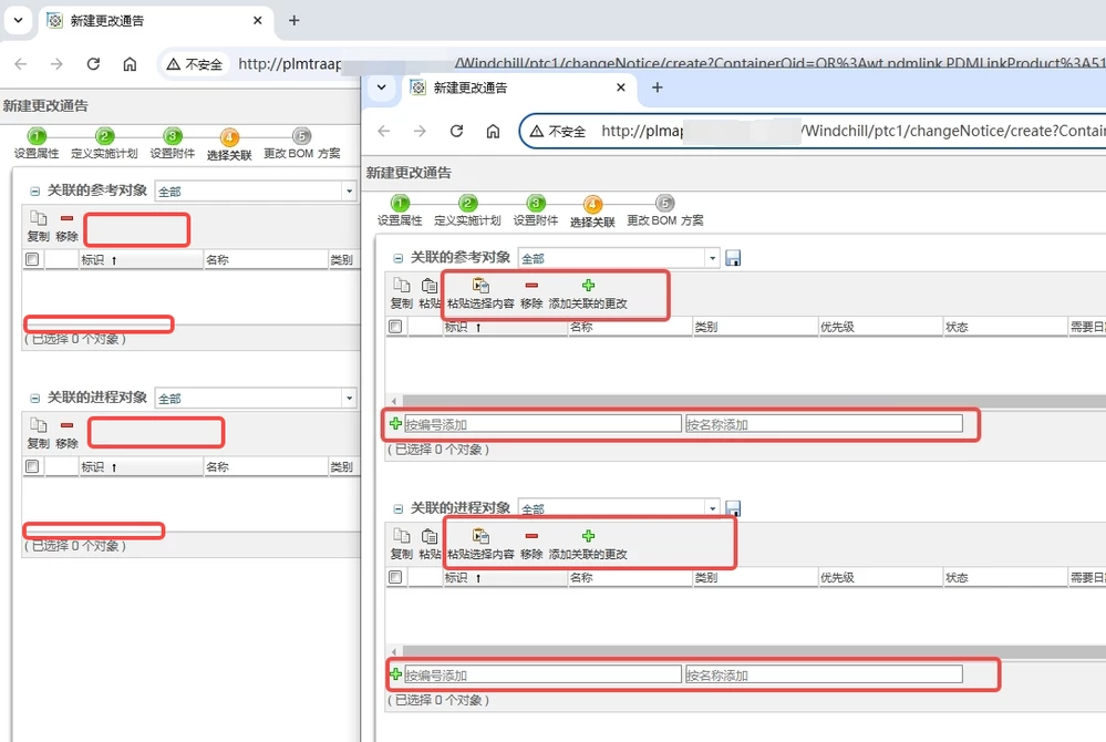

When creating a new ECN, how to make the wtpart search and selection on the associated page
I am using Windchill PDMLink Release 11.0 and Datecode with CPS M030
The Select Associations page lacks some functions (3 buttons for Paste, Paste Selection and Add Associations are missing, and searching and adding items by number or name is missing)
Translated by the moderation using Google Translate
选择关联页面缺少部分功能(粘贴、粘贴选择内容、添加关联的更改 3个按钮缺失,按编号、名称搜索添加条目缺失)

I have solved this problem, just configure businessRules

I don't no why the plmtraap   page does not show the  buttons and the search input bar, how to configure to make it visible.
不知道为什么plmtraap域名所在的页面没有标出的按钮和搜索添加框,怎么配置让它们显示在页面上?

This looks like its related to licenses assigned to the user or access rights.

But How can i find the configuration, could you give me some pointers please?
