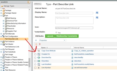

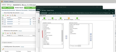

Where do i see the Part Describe Link Attribute ?
I have created a custom attribute on Part Describe Link (Line Number).
Unable to find it in Part's Related Object.

The place does not exist.
System does not support to show the WTPartDescribeLink own attributes.
If you want to show them then you can use queryBuilder reporting or own customization table to show that information.
Ok Iam wrong with my first answer. It was not so precision 😄 .
If you want to show it you can show the attribute in the structure of the WTPart
But you can not modify it so anyway it is not useable without customization.

try with alias attribute on wtdoc with mapping
describedBy@wt.part.WTPartDescribeLink~<WTPDescIBA>
My quiestion is how do you initialize the IBA on the link ?
