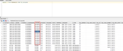

Where should I get "v$session.osuser " And how to change the String limit of osuser name.
Best answer by Cliff_17466
Please refer to below. OSUSER is the login user of Oracle client machine (e.g. the OS user who logged in Windchill server OS and start Windchill), and cannot change.
Cliff
Cliff
January 16, 2023
execute sql via DBA user (not Windchill DB user)
select * from v$session;
Cliff
January 16, 2023
Thanks for replying
I'm not getting OSUSER as 'revati.sonkawde@pluraltechnology.com' anymore by executing
Select * from v$session;
I want to update this username i.e. 'revati.sonkawde@pluraltechnology.com' .
