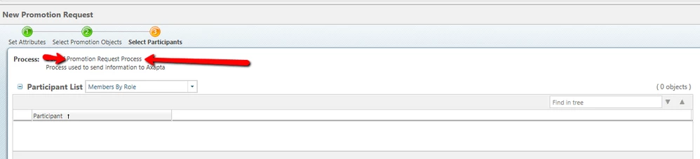

I want to do a promotion request with API and it works with this:
https://www.ptc.com/en/support/article?n=CS133053
But within this request the process isn't selected well. If I do it manually the process is selected automatic, if I do this by API the process isn't selected. How can I add the process to the promotion request with API?
This topic has been closed for replies.
September 7, 2018
Seems the process is in fact the workflow that should be followed. How can I do a promotion request by code (API) and link the correct workflow to the promotionNotice?
