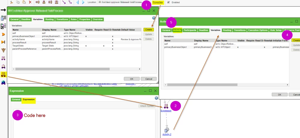

Where to write the code?
Tell me please where to write the code https://www.ptc.com/en/support/article?n=CS150777 , tried many options, but failed nothing. Here is the code to add a table to the page

  1. Create global variable (say var of type String)
  2. Before activity add expression robot
  3. Append string to have all the promotion objects' numbers/names
  4. In activity create local variable
  5. Use that local variable in instructions

Oct 10, 2019 12:40 AM UTC
Hope this helps. The local variable should be initialized from the global variable. Local variables are only needed for activities, not for robots (like expression or email robot).

Oct 10, 2019 5:22 AM UTC
yadavankur, thank you very much, tell me, is it in the template Promotion Request Review Process should be written or in another? And how to check that the attempt was successful?
Oct 10, 2019 5:39 AM UTC
Assuming your Windchill is completely out of the box, you will set up the code and the variable in the two Promotion processes that PTC provides. If you are not sure check promotion preference management under site>utilities and org>utilities If you want to use the variable in a workflow activity instruction you would use it like this {myLocalVariable} to check your attempt you will create a promotion and view the instructions on the task that you receive. Here are two example variable in use in a notification robot (not in activity).Variable.PNG
