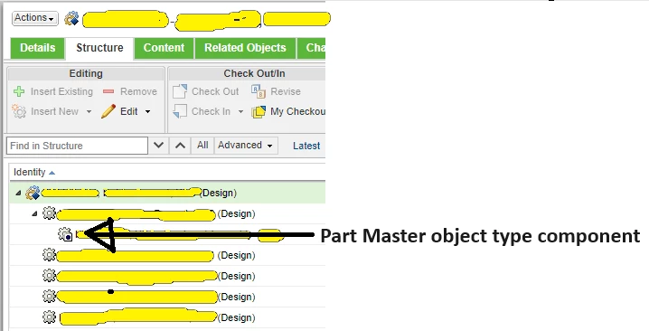

Working on customization task, need to call Part Master object type so for that i need WTPartMaster API.
see attached screenshot for the reference.

Hi @Vaibhav_Thakare
It is very simple
if (object instanceof WTPartMaster)// for your case ignore this object.
 WTPartMaster wtpm = (WTPartMaster) object;
You don't need any WTPartMaster API

Hi @Vaibhav_Thakare
What do you need?
Just use if instance of WTPartMaster and retype the object to the WTPartMaster object.
Thenn you can work with Master as you need. getNumber and so on
Usually if you see master in the structure, it means that the object does not meet filter criteria or the user does not have a access to that object.
Structure filter has a option (check box) to do not show master objects where the filter is not met.
PetrH
February 14, 2024
Need WTPartMaster API which will help to identify WTPartMaster component/items in BOM, so i can exclude those items from our customized BOM report.
