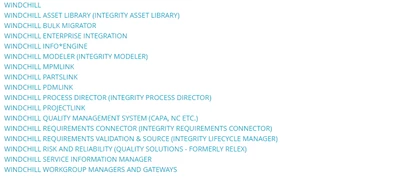

Not sure of your business needs but I would say PDMLink would be the base. Sounds like you should get a complete overview from your rep.
22-Sapphire I
September 19, 2022
You may be thinking of index search (which is Sorl from microsoft, provided by PTC).
If so, you need both the index search server and client.
HelesicPetr
September 19, 2022
@AP_9587236
Also if you need part classification there is a Windchill PartsLink
