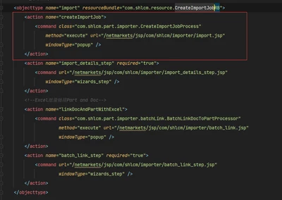

Why does my action is hidden by a validator which I did't wrote it in the action.xml.
August 19, 2022
I would suggest du rename the action. There is an OOTB validator defined in codebase/com/ptc/windchill/ixb/ixb.service.properties.xconf
<Option requestor="null" serviceClass="com.ptc.windchill.ixb.importer.jca.validator.ImportFromSpreadsheetActionValidator" selector="createImportJob"/>

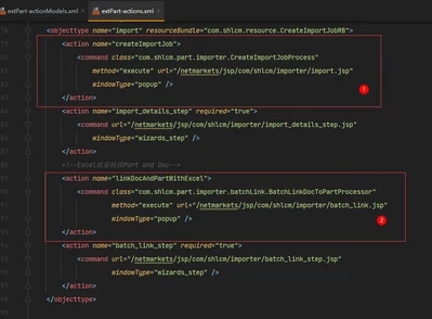

guide_me9-GraniteAuthor
9-Granite
August 19, 2022
I added a another action below the first one. The "linkDocAndPartWithExcel" action do not missing and its filter is not the same as first action.
