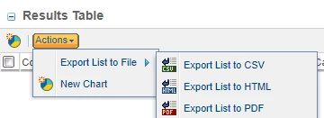

Hi @sdicarlo
Each query builder result table contains action where you can export the results.
PetrH

Hi @sdicarlo
PetrH
