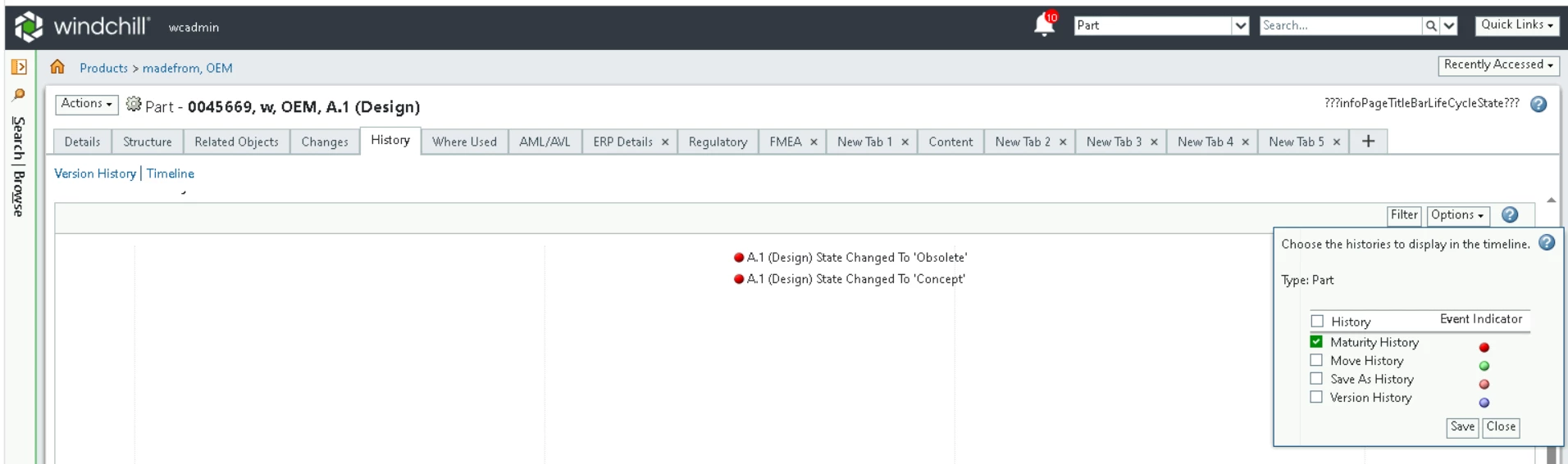

Windchill 13.0.2.11 - How to hide the "Rename History" option in Timeline History?
We are using Windchill PDMLink 13.0.2.11 and need to hide the "Rename History" option from the Timeline History dialog.
So far we have:
  • Enabled JCA Debug Mode.
  • Verified there is no ladybug/debug icon associated with the Rename History option.
  • Reviewed the available ACE support files and could not find any DAT or UI configuration related to this action.
Has anyone customized or removed this option? Is it controlled through an Action Model, MVC Builder, Java customization, or another supported mechanism?
Any guidance would be appreciated.

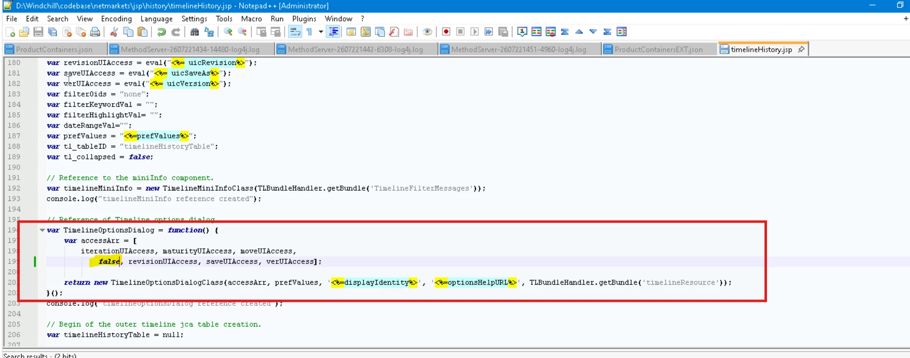

23-Emerald II
Jul 23, 2026 10:40 AM UTC
Make below change :

23-Emerald II
Jul 23, 2026 7:55 AM UTC
Do you need to remove it for all users ?
Buiꓘa
3-Newcomer
Jul 23, 2026 8:58 AM UTC
Yes, for all users

Fadel23-Emerald IIAnswer
23-Emerald II
Make below change :
