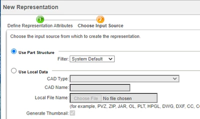

Is this Windchill 12 and higher or were your referring to Windchill+ (Cloud version)? I can say that if Part is not connected to CAD, you can create a new representation from a file upload. If there is a CAD model associated, that UI goes away.  No feature in UI for CAD models.
