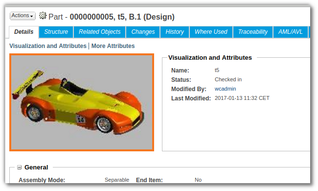

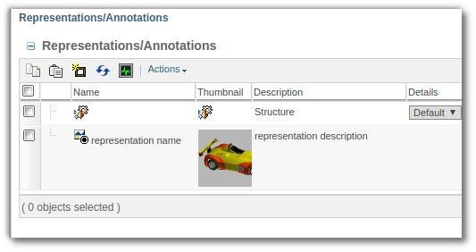

tested with loadFiles/wvs/demodata/worldcar/worldcar.pvz on a part :

HI olivier fresse
      Thank you very mcuh, I could able to upload the representation for WTPart and EPMDocument by using the API that you provided.
