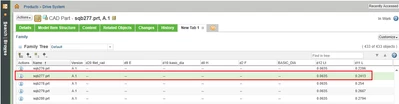

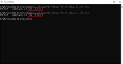

Yes, this is doable.  I wrote my own code to do it.  Works well.
In the browser I see this.
Code returns this.
Aug 13, 2024 8:43 AM UTC
Thanks, but can you please share code example or APIs.
