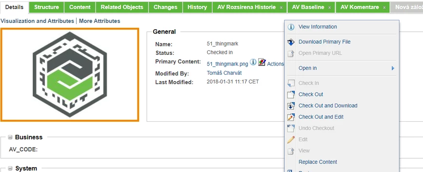

I'm looking to add an action to the PrimaryContent attribute in General group under the Details Tab as shown in the attached image.
Just like how the PDF icon in the value downloads the PDF when clicked upon, I need to add another icon that performs an action.
Could anyone help me with it? Need API ways or any other workaround.

Do you need something like following picture?
PetrH
December 1, 2022
Hi @HelesicPetr Yes exactly. I need to add a similar icon next to the info icon on the PrimaryContent attribute value only for wt.doc.WtDocument types.
The icon when clicked will open a url that's generated dynamically.
