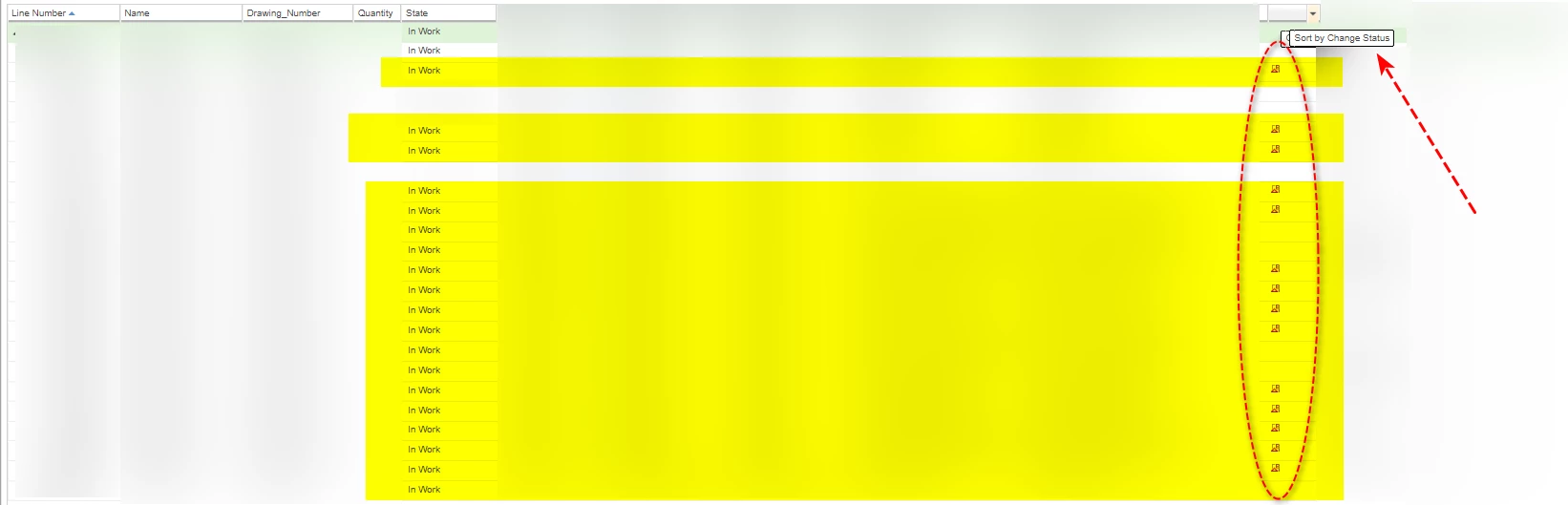

When doing change management and new product releases in Windchill, our designers have difficulties to inspect that all necessary items have been added to the change object (ECN / resulting objects).
We can modify the WT-structure view to show "change status" column. That shows us a clear visual view to check that all necessary items (WT-parts) have been added to the change notice.
Problem is that in assemblies CAD-structure view its not possible to get "change status" to be shown. The change object (EPR, ECR, ECN) is linked to every WT-part and CAD objects when the object has been added to the change notice. And it can be seen in single part CAD-view etc, but problem is that in bigger assembly views, single CAD-part "change status" cant be seen.
The status can be seen in WT-structure view, when selecting the wanted WT-part from the assembly and under "Viewing" - "Show" - CAD documents. This opens all cad documents related to that WT-part, and then the "change status" can be seen. Still - this method is too slow and also gives unwanted material to be seen. We want to find more simple way to check bigger assemblies at once.

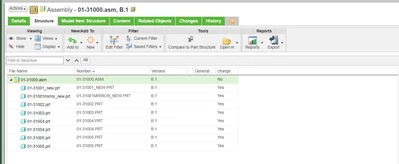

have posted  a workaround few seconds ago , it may take time to load video ., I'm not allowed to vote,  as i'm PTC internal
Buiꓘa
Fadel
23-Emerald II
September 4, 2023

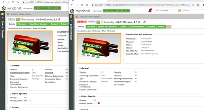

I tried to to combine , 2 calculated attributes , one string to get the status as string and a second long one to show the status as a graphical reoresenataion (xconfmanager -s com.ptc.GraphicalAttributes.enabled="true" -t codebase\wt.properties -p + sever restart to be enabled) ,
however the graphical attribute is not available in the structure for selection only the string one
