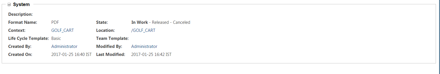

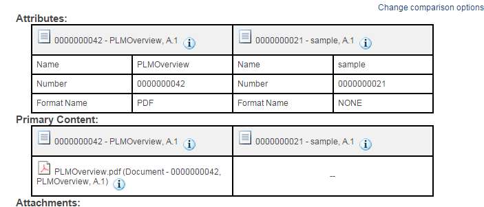

so i created an action and called a jsp inside the action . inside the jsp , i called the builder class . i had a piece of code to create a panel , group and adding the group to the panel. i registered the builder . but still not getting the results . once i got an error stating unable to create or find builder .  i want an action say something like report  , for a document . on clicking that action i want a new page which displays the attributes of the document either in a panel or as a table format ( for example) .doubt1.PNGdoubt2.PNG
i might have been wrong in my previous steps.i would like you to tell me the step by step procedure to do panel configuration. ‌Binesh Kumar‌
