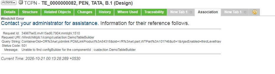

I am new to windchill customization need help to fix my issue related to table building activity
i have created an customaction.xml as below
   <objecttype name="tab" resourceBundle="custaction.CustActionRB">
   <action name="Association">
   <component name="custaction.DemoTableBuilder" />
   </action>
   </objecttype>
i am able to find the action button but when i am trying to load the page i am getting below error

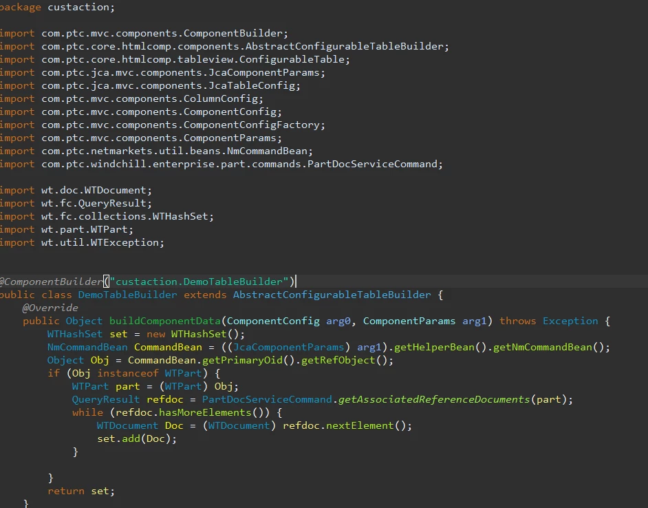

my code seems to be good
Java class
Kindly help me to fix the issue

Did you add an entry to to codebase/config/mvc/custom.xml file?
Something on the order of:
<bean class="custaction.DemoTableBuilder" />

​@RandyJones It worked thank you so much
should this entry to be added for all the customization related to table builder
can you please explain why this is need ? i have not added such things while creating custom actions and wizards
20-Turquoise
Oct 21, 2026 1:32 PM UTC
​@Siddesh
I learned this years ago from taking Felco Solutions “Windchill Customization Course”.
https://www.felcosolutions.com/training
All table builders need to be “registered” in custom.xml.
A couple of PTC articles:
https://www.ptc.com/en/support/article/CS299381
https://www.ptc.com/en/support/article/CS350196
