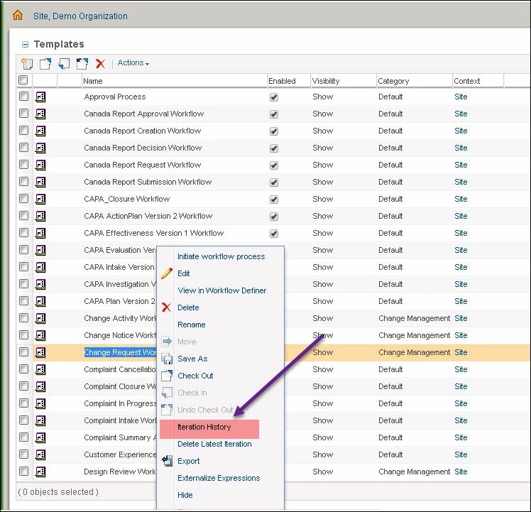

Someone at my company has gone in and modified the out of the box workflow templates instead of doing a save as. Now the ECR workflow specifically is messed up. Is there somewhere that I can get the out of the box workflow templates to import back into out Windchill database?

Here is way. Workflow Template > Right Click > Iteration History.IterationHistory.jpg

We are on Windchill 11.0 M030-CPS11
October 30, 2018
There should be iterations of every save. Go back to the original iteration.
dfolk11-VisitorAuthor
October 30, 2018
Where do i locate the earlier iterations?
ShirishMorkhade
October 30, 2018
@dfolk1,
