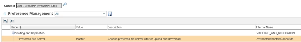

Where is the location of the file that contains the information for the settings listed in Preference Management in Windchill PDM link 11.1? I created a new user in Creo Parametric 7.0.6.0 and my new user preferences in Preference Management are only show default settings.  I would like to import my settings from my other user Preference Management settings into this new user account.  Is there a way to import these settings from my old user account into my new user account?Perhaps I am not asking the right question with a location, how does one go about exporting the Preference Management settings and importing them for an individual user?

Preferences are stored in the database. Your image shows you are looking at the site level which should be the common defaults for the system and all users. I do not know of a way other than data loads to copy or transfer settings for user preferences from one user to another. A new user would indeed inherit from the defaults. I suggest using two browsers and do a side by side comparison of the preferences to make them match.

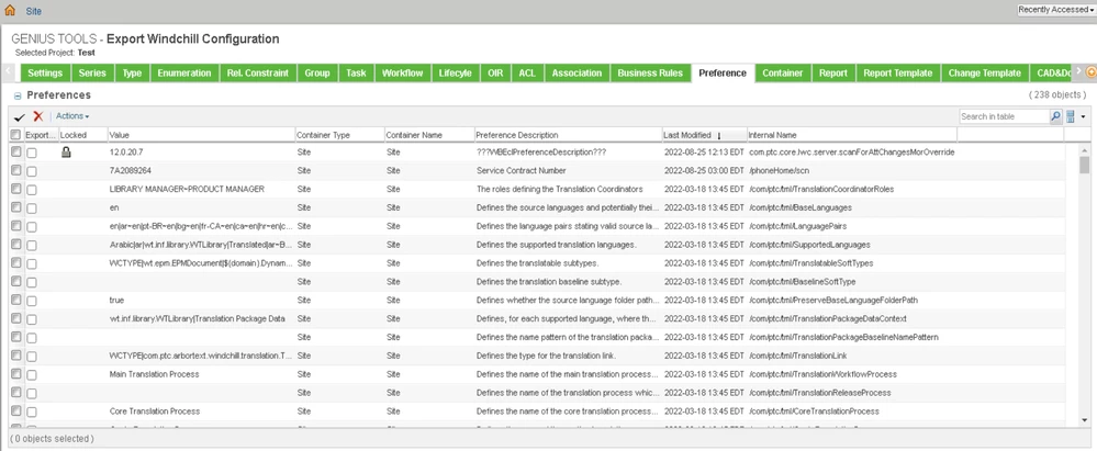

Shameless plug... Genius Tools for Windchill has a "WINDCHILL EXPORT/LOAD PLUGIN" for 11.x and an Administration bundle for 12.x.  Either can export/import business configuration, including any preferences that have been set at the site, org, and/or application context level.  This solution supports more content than PTC's Business Administration Change functionality and has a GUI interface.  The tabs you can't see in the image include: CAD & Document Templates, Table View, Standard Profile, Client Tab, and Saved Search.
It is a great tool for cloning business configurations between systems and cherry picking from one business configuration to add to or overwrite another.  It is essentially a front end for LoadFromFile with some enhancements.  Chosen configurations can be exported to disk from the source system and loaded into the target system.  Once on disk, the configurations can be source controlled.  But it does not export/import individual user preferences.
