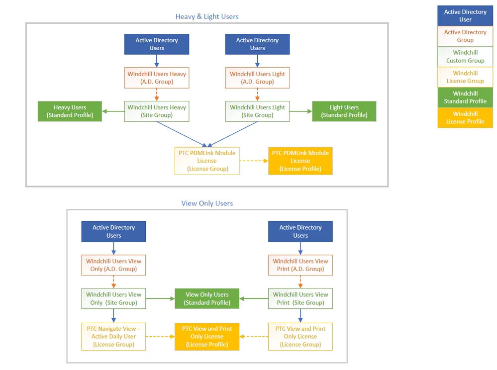

6.) I like the idea of the groups, and I chose to do the License profiles this way by creating specific license groups.  However, it sounds like you have gone a step further and associated multiple profiles with groups.  At least with the License groups we were cautioned against not assigning more than one of the same type of License group (e.g. View&Print and Base) to the same person because then it would reserve/pull licenses for both.  Is this what you are doing, or do you only do that for the custom profiles where you add more and more functionality depending on their role?
December 2, 2021
No, only one profile per license group.  I add each user to multiple ORG level groups in order to grant them access to different roles, but their top level Active Directory group is only ever associated with one license group, one license profile, and one standard profile.  Any other limitations to their functionality are role and context specific ,and handled by the access control rules for each context.
Obviously larger organizations are going to have more complex licensing requirements, but this is what we have:
