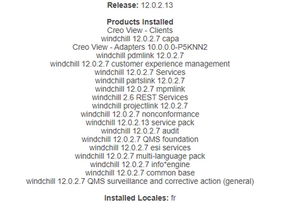

Recently installed Windchill QMS packages via PSI on Windchill 12.0.2.13

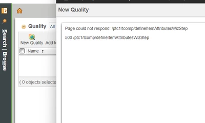

We are unable to load the default QMS via the loadFile utility:
"Invocation of wt.inf.template.LoadContainerTemplate.createContainerTemplate failed with the following argumentskey = TARGET_CONTAINER_KEY value = wt.inf.container.ExchangeContainer:3
No objects were imported due to the error.
Problem in export/import process.
Nested exception is: wt.util.WTException: java.lang.reflect.InvocationTargetException
Nested exception is: java.lang.reflect.InvocationTargetException Error loading data from file.
data file = <D:\PTC\Windchill\loadFiles\qms\QMSContainerTemplates_AUDIT.xml,D:\PTC\Windchill\loadFiles\qms\QMSContainerTemplates_AUDIT.xml>
map file = <null,null>
token separator = <null,null>
method = <null,create>
user = <null>
Command line = <{User=, Password=}>
Nested exception is: java.lang.reflect.InvocationTargetException"

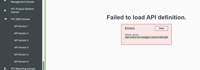

And when trying to access the OData APIs,:

Hi @ZahyMatar
I would like to ask if you finish all post install steps because it seams that something is missing or is not configured properly.
Windchill Quality Management Solutions Post Installation
CS168808 - Manually load base data in Windchill QMS
In the end I would open a PTC Support Case
