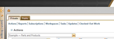

I'm trying to understand if customizing the Windchill Theme is a common customization - See (Customizing the Theme (ptc.com)
Do you do more than just rebranding?
- Do you customize other colors - like font color?
- Do you customize font size?
- Do you use custom icons for the standard icons (other than custom Type icons)?
- Any other similar customizations?
Can you share examples of what you've done?

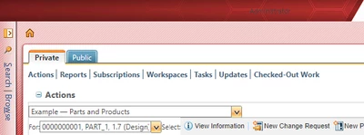

I try to leave Windchill as OOTB as possible to make upgrades easier.
The one change I make to xtheme-windchill.css is the background color. Since I have multiple Windchill systems, at one time I had 3 running production data, I use the colors to quickly see which system I am working with. Usually the users don't see or use all systems, but as the admin, I do.

I usually change a color schema that is based on a customer's company color schema
I change, the general color schema when I modify almost all colored icons that build the page look,
logo style, alert message style.
Yes there is some effort to do so, but it is fun :D.
