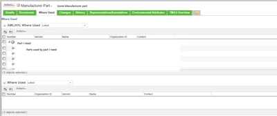

Windchill REST API: Get AXL Where Used table data of a manufacturer part.
Version: Windchill 12.1
Use Case: Finding a standard part's ID from a manufacturer part that is in its AXL list.
Description:
So far I can find the correct manufacturer part's ID. Looking at the Web UI; I can get the Where Used' table's data using : /Windchill/servlet/odata/ProdMgmt/Parts('VR:com.ptc.windchill.suma.part.ManufacturerPart:XXX')/UsedBy
But the part I need to find is in the 'AML/AVL Where Used' table and I can't find the request to acquire this data.
Anyone has an idea or maybe how to tackle the higher level requirement of;

We are having exactly the same problem, would be very kind if anybody has a solution for this.
