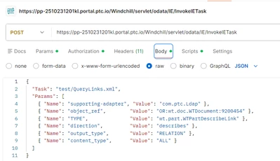

Use Case: I am trying to bulk load part instance and part configuration objects into Windchill and to establish the links between them and the parts they are related to.
Description:
I was hoping to be able to do this with the REST API but it doesn't look like there are end points available to allow this to be done. Can anybody recommend an alternative approach to achieving the same goal?
Best answer by Fadel
You can make and info*engine task that creates objects and call it in WRS using invoke task endpoint
something like below ;

Hi ​@Fadel ,
Is there a straight forward approach using a REST API call for Part Instance?  Currently Iam seeing that Part Configuration and Part Instances are not supported in the WRS Domain.
Is it possible to create a custom domain for this purpose?
