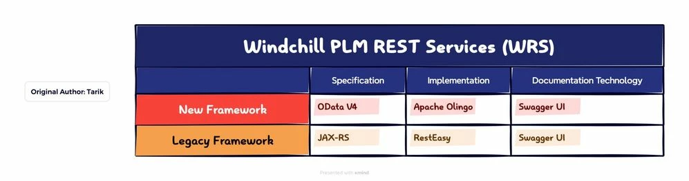

Two Frameworks
- Windchill REST API has two frameworks; the old one is based on RESTEasy, and the new one is based on OData, while the old framework is still available...it's mandatory to use the new one (OData).

Doc
- Yes, WRS is documented using Swagger Technology:
