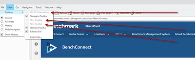

Mar 19, 2025 9:18 AM UTC
To explain it a little bit more:
The TOP ribbon contains the dropdown menus: FILE  VIEW GO etc.
Just below it there are the TABS: MAIN HOME etc.
Is it possible to customize these?
I have seen already that it is possible to add more tabs:
But I can not find a possibility to add icons or start commands to these additional TABS or toolbars.

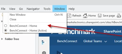

Beside of the above I have seen that it is possible to open several Windows:
But when you arrange that you are loosing this when you close the application and start it again.
I hope this is clarifying I little bit where I am looking for.
