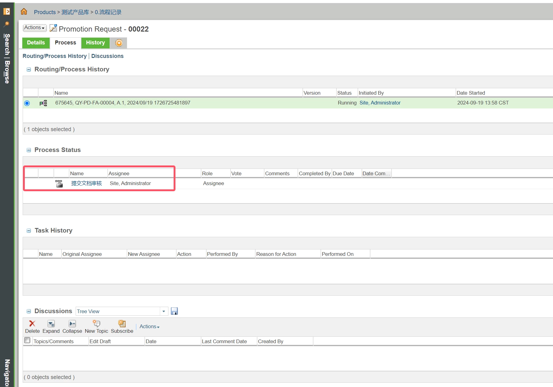

Description:
The customer complained that they are unable to view all task nodes and can only see the current task node. I now need to adjust the display mode to show completed and unfinished nodes.
May I ask how I should adjust

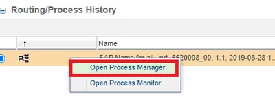

Hi @ZK_11667139
It is a promotion request it is not change object so the structure of tasks is not shown.
Only a history table of completed tasks is shown.
You can just open the Process Manager to see full process(Process Manager) or saved picture (Process monitor) of the process description.
