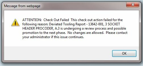

I'm having a workflow issue and hope someone can help. We have a process whose workflow requires approvals. Each approvers is given 2 options (votes), Complete or Rework. If all approvers vote "Complete", the workflow moves along to the next activity (coordinator approve and release), as expected. However, if any one approvers votes "Rework", the process assigns a Rework task (expected) but also moves forward to the next activity. This causes an issue for the person assigned the Rework task as they can't update or edit the object because it is undergoing a review process. (See attachment for error message) This also means you can't change the state even from an admin account either for the same reason. Any ideas as to what is happening?

I am guessing that you are using 'All' to ensure that every approver provides a vote before you can move forward.
So, if one of them cast vote as 'Rework' system is triggering 'Rework' task and if another approver select 'Approve' the system is triggering the next task for 'Approver'. The system is behaving as expected.
Use the tally expression so that workflow always goes to 'Rework' if any one of the approvers selects 'Rework'.
This is a classic example of using tally.

I'm currently running 10.2 but I took some of the info you referenced and was able to get it working. We actually ended up creating a new LC sate and using some of the coding and it seems to be working.
