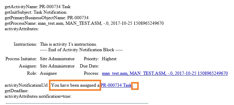

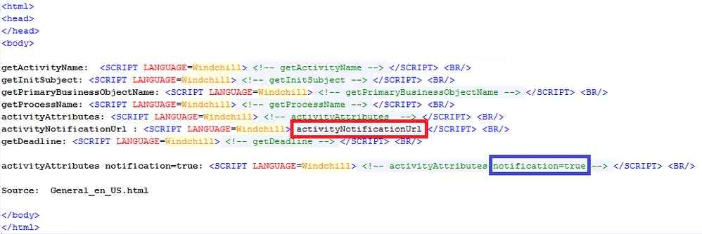

I am working on customizing the workflow task notication templates and have a few questions.
1.)  Why does the activityNoficationURL method not get put in comments but all of the other methods do?  (It will fail if placed in comments.)  [Red Box]
2.)  Where is the extra condition "notification" for activityAttributes documented.  [Blue Box]
3.)  How do I get just the task URL without all of the extra garbage?  [Orange Boxes]

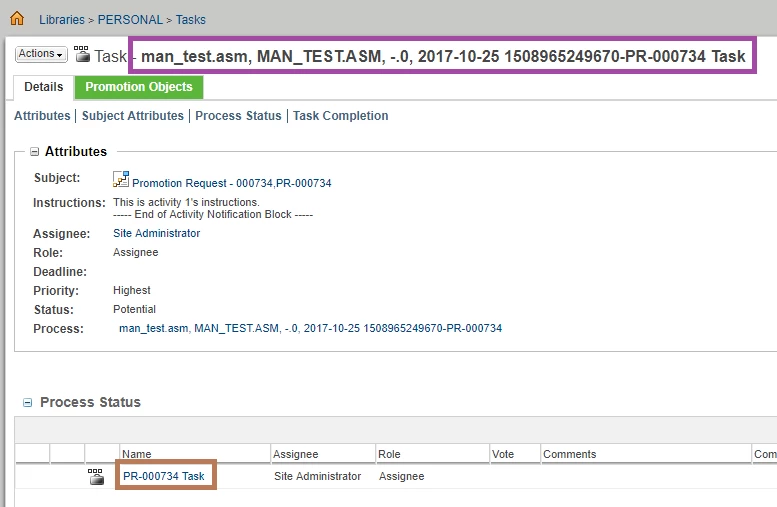

4.)  Why does the task list the process name instead of the task name?  Is this controlled by a preference?  If not, can the process name itself be changed?  (I'm already dynamically changing the task name.)

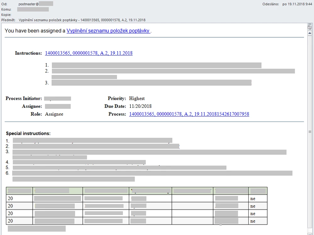

Users simply want to be able to look at the email and know if they need to take action without having to log in. The issue is made even worse when the task gets completed by another user, navigating to the task gives you the not found error message. I would pay hard cash to someone who fixes that. Either way, I can create an alternate link so if that link is gone, they can still find out what the hubbub was all about.
November 19, 2018
Don't have any answer. I was just trying to add special instructions, cause regular instructions field is limited by 4k characters.
Only here to say that this is horrible, really horrible. How am I supposed to translate the labels and change 'Due Date' to DD.MM.YYYY format?

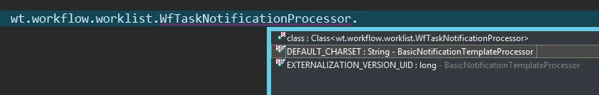

Thanks for the reply. I'm not really sure about the template processor approach. I've tried to look at the class wt.workflow.worklist.WfTaskNotificationProcessor with Eclipse, but it doesn't expose anything usefull.
No clue where to look for service.properties mentioned by @avillanueva.
