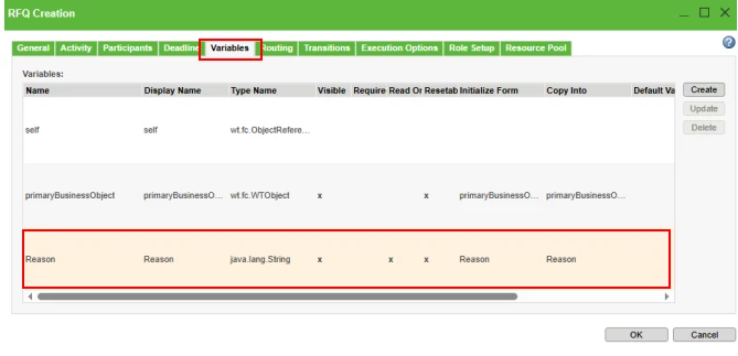

I am using Windchill PDMLink Release 12.0 and Datecode with CPS 12.0.2.4 Windchill Workflow Issue: I created a global workflow process variable and assigned the current task activity comments to it. The value is displayed correctly in the current activity using System.out.println(). However, when I access the same process variable in the next workflow activity, it returns null instead of the expected comment.

Hi ​@SD_12555453,
How are you accessing it?
Could you please share a screenshot?
Aug 7, 2026 6:50 AM UTC
In the next activity, I am using the process variable on the task page. However, the variable value is null. If required, I can also share the code for your review.

​@SD_12555453 are you sure you want to have “Resetable” set on this?
That ought to clear the value to default - which looks blank in your image - every time the workflow process node is started.
