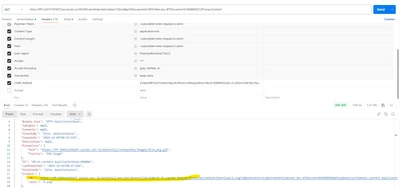

WRS API to Download the Document from Windchill
Version: Windchill 12.0
Use Case: To get a Downloadable URL for the Document's in Windchill
Description:
There is a Use Case to download the Documents from the Windchill to Thingworx, I am trying to find a WRS API for it, but I couldn't find one.
Is there any WRS API, present?

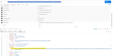

try one of these :
<server>/Windchill/servlet/odata/v7/DocMgmt/Documents('OR%3Awt.doc.WTDocument%3A888002')/Attachments/
<server>/Windchill/servlet/odata/v7/DocMgmt/Documents('OR%3Awt.doc.WTDocument%3A888002')/PrimaryContent
