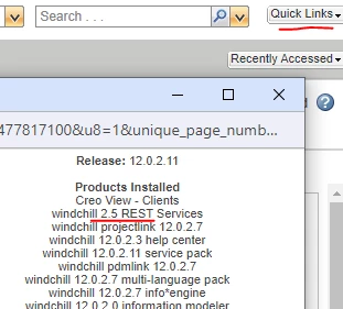

May 23, 2024 3:30 PM UTC
Which version of Windchill do you have?
Which version of WRS ? Go to
yourdomain.com/Windchill/netmarkets/html/wrs/doc.html
At the bottom of the page there is a link to
https://support.ptc.com/help/windchill_rest_services/r2.5/en/
In the above you can see it's version 2.5.
Or go to
Just one more question: do you see errors in the log when you try to run a report like this?
