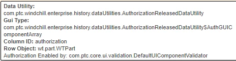

avillanueva
23-Emerald II
July 6, 2023
This is the data utility that generates the data which could help you.
