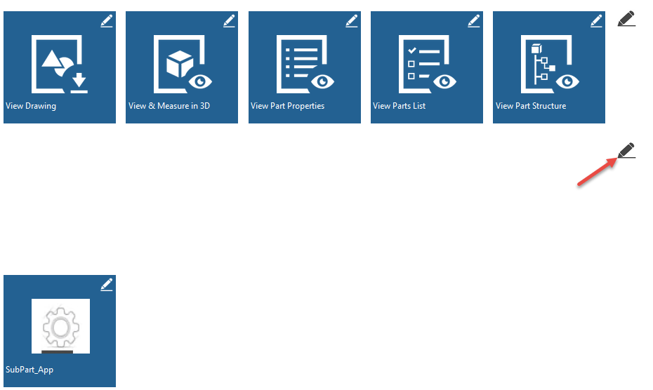

I am able to create Custom app on the PTC Navigate landing page, but the app is only available for Administrator. I am not able to find the Edit Icon for the Custom apps to Tailor for the Users. Can any one help me in bringing the Edit Icon for Custom app? Is their any documentation available to bring the Edit Icon and Tailoring Mashup that helps to Tailor app for the User Groups as functionality available for default Navigate Apps?
