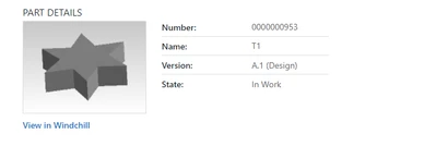

Hi, can i add some Attributes in Part List under State?

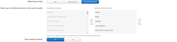

The Administrator can specify up to five attributes from the attributes list on the tailoring page that will be displayed on the Part Details page.
vcavic1-VisitorAuthor
June 14, 2021
Hi @barko, i have Administrator Account. But i can't find these settings. Is that in Edit Collection or?
June 14, 2021
You are at the right place. On the left are available attributes, which are the results of an attribute query that is is already included in the OOTB Navigate. On the right are the (up to) five attributes that have been chosen to be displayed.
