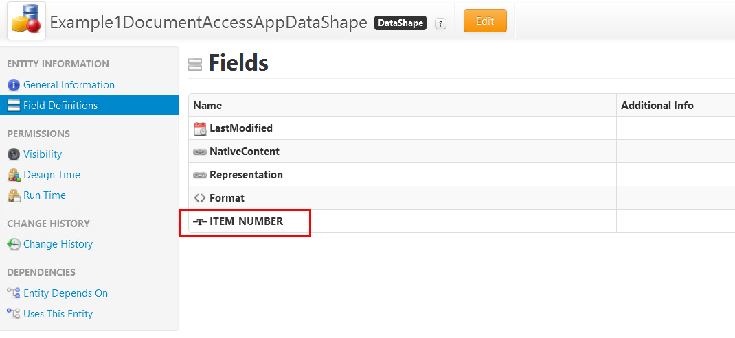

Can anyone guide me with the steps to include Windchill attributes (IBAs) to the results being displayed in View Document app search results?

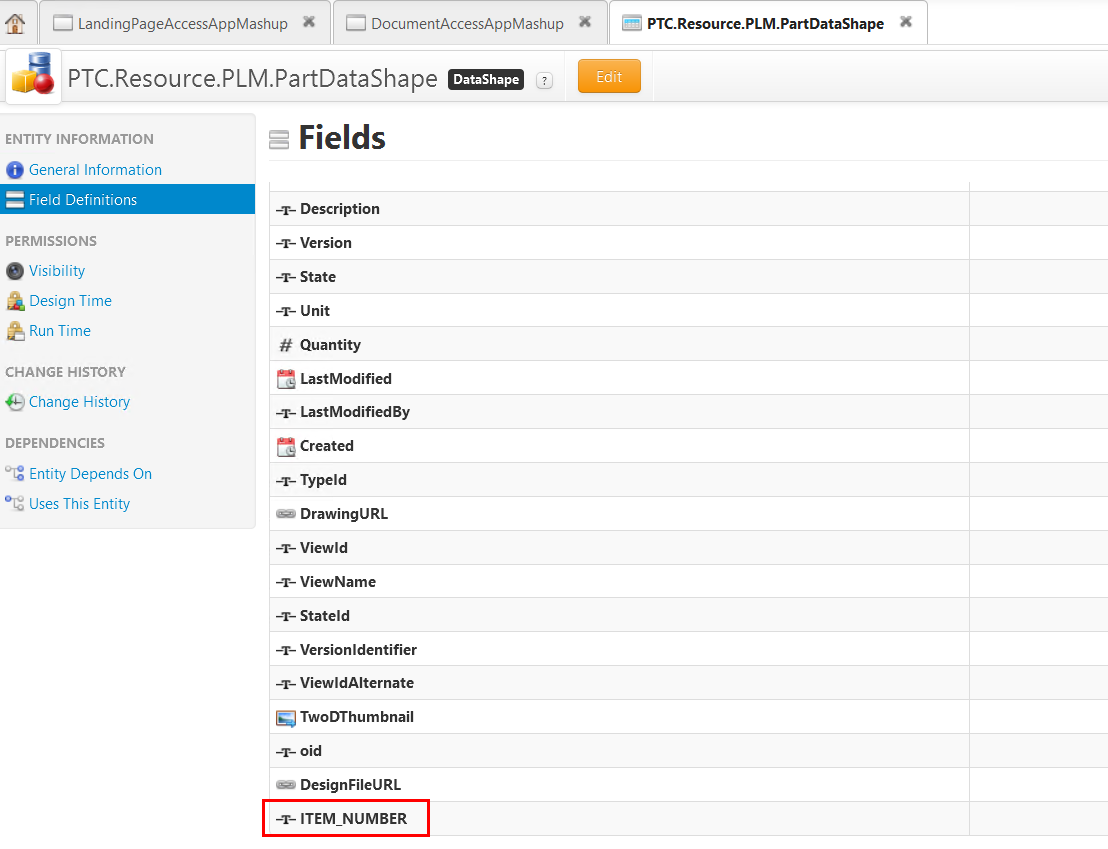

I had created the the attribute in the Field Definitions in PTC.Resource.PLM.PartDataShape
Also included the same in Example1DocumentAccessAppDataShape which is being used by the View Document app

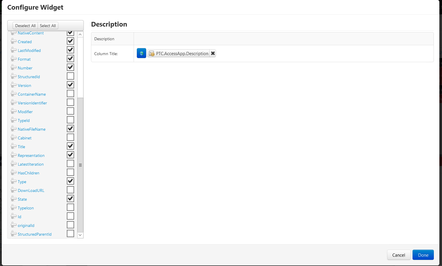

But when i try to Configure Widget in DocumentAccessAppMashup, i don't see this Windchill attribute coming in
Can someone help me on this?

Probably a dumb question, but did you try refreshing the mashup or remove the data source for the grid and re-adding it so you could see if it added the field that you added to the datashape? Sometimes there are issues where things just aren't in sync
