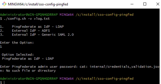

I want to configure PingFederate as an IDP.
I have finished configuring SSL for the three servers.
But, the automation scripts in ptc guide articles do not work on Windows OS.
Where can I find instructions on how to manually configure PingFederate?
Jul 24, 2023 8:16 PM UTC
Hi @hno
If you are using the Windows OS, install Git Bash to run the scripts. You can download the latest Git installer from https://git-scm.com/download.
This is listed along with other pre-requisite steps for the automatically configuring Ping as the UDP here Before you Run the Automation Scripts (ptc.com)
If you still do not want to complete the install automatically with the scripts, you can check out the additional instructions on our help center for manual configuration here: Welcome to the PTC Identity and Access Management Help Center
