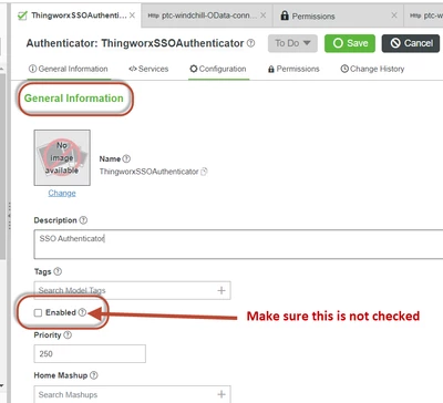

Depending which authenticator you are using, either the ptc-identity-provider-authenticator or the ThingworxSSOAuthenicator, you can uncheck the Enabled box under General Information. This should stop automatic user creation, which is configured in these authenticators.
Here is a shot from the ThingworxSSOAuthenicator:

We are passing authentication back to Windchill so the accounts match. ptc-identity-provider-authenticator is enabled but not sure your suggestion to disable it makes sense. Doesn't that disable the entire connection to authenticate back to Windchill?  There is an option under Configuration that is checked which says "CreateUserDynamically" and that is checked.  This seems like the place right?
